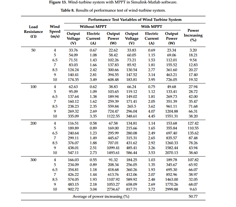

Gepostet: 27.03.2022 - 21:40 Uhr  ·  #20
. Overall, the MPPT controller is able to increase the wind turbine system’s power output
significantly. The average power increase after installing the MPPT controller using the PO algorithm
is 50.77%. The results are presented in graphical form to clearly analyze the effect of the MPPT
controller on various wind speed variations, as shown in Figures
https://mdpi-res.com/d_attachm…-03938.pdf
