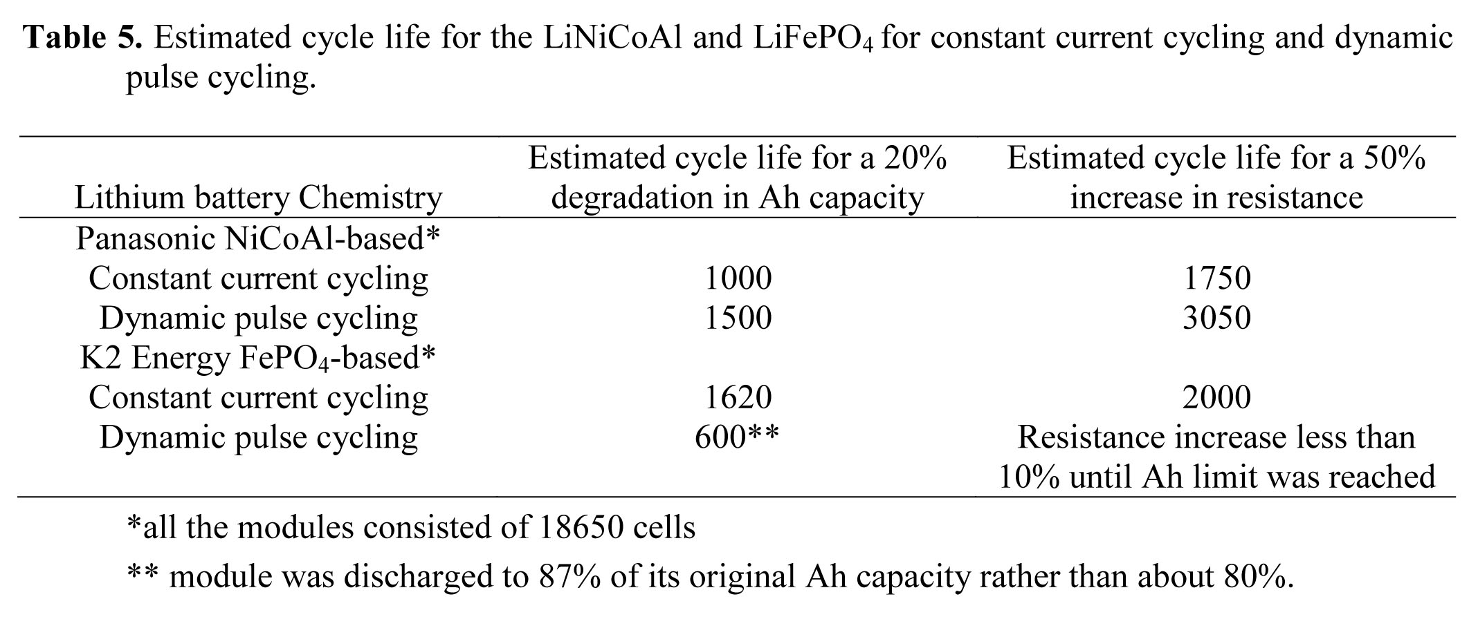

http://www.electrochemsci.org/papers/vol13/130201773.pdf
Table 5.Estimated cycle life for the LiNiCoAl and LiFePO4 for constant current cycling and dynamic pulse cycling.Lithium battery ChemistryEstimated cycle life for a 20% degradation in Ah capacityEstimated cycle life for a 50% increase in resistancePanasonic NiCoAl-based*Constant current cycling10001750Dynamic pulse cycling15003050K2 Energy FePO4-based*Constant current cycling16202000Dynamic pulse cycling600**Resistance increase less than 10% until Ah limit was reached
