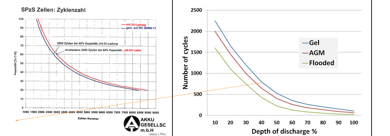

[quoteArtificial cycling of the battery With the ON/OFF control method some energy is put in and out of the battery all the time during the topping charge. There are microcycles done. What is the effect of this on the battery lifetime? Battery is a costly and sensitive component in the system. It must be handled with care. [8] discusses more about microcycles for renewable energy systems and show that the energy throughput question is important. -15-10-505101508:2409:0009:3610:1210:4811:2412:0012:3613:12Battery current [Adc]Test of SB1700 with standard DE settings24.525.526.527.528.529.508:2409:0009:3610:1210:4811:2412:0012:3613:12Battery voltage [Vdc]time [hh:mm]1hour absorbtion
There is a graphic that is given by battery manufacturers that correlate the depth of discharge (DOD) and the number of cycles. Generally this relationship is interpreted in the way that a low DOD is good for the battery life time. But actually at 40% DOD the number of cycles is about the double than the one with 80% DOD. The energy in transition through the battery is then about the same, and the real use of the battery is about the same. If the graphics is interpreted in term of energy, the energy going in and out of the battery is , we can say that using at 40%DOD for 3600 cycles a battery there is , for a battery capacity normalized to 1. And using at 80%DOD for 1650 cycles a battery there is . The ‘quantity of use’ or ‘energy throughput’ of the batteries decreases little with a high DOD, less than 10% of energy difference between 40% and 80% DOD. From the cycle number figure, the following graphic of the energy through the battery can be plotted. Conclusion of this graphic is that the battery lifetime is more or less given with a given quantity of energy over 80%. Manufacturers give the warning that the battery should not be used over 80%DOD. If the battery energy throughput is given, then the microcycling has an impact on the battery lifetime. We have to determine if this is relevant or not compared to normal use. Factor that influences this is how many times a day this microcycling is done, and this depends mainly on the balance of the load profile compared to the solar production profile. Per example if there is always less solar power connected to AC than loads, then there is never the necessity to stop the grid inverters and there is absolutely no microcycling and no impact on the battery life time. Another scenario would be that there are no loads at all and solar is produced. In that second case there is also surprisingly no impact on the battery life time. Because energy is only going into the battery, not out of the battery, there is no cycling. There is cycling in between those two cases, when there are loads and solar and the same time and there are less loads than solar power available. Data under 20% DOD were not available. So we made the assumption that the tendency continues similarly. If this expectation is correct for the mentioned OPzS battery, you could make around 55000 cycles at 3% DOD and 330000 cycles at 0.5%DOD. For the example given above with the SB1700, 1 minute at 500W load with 26.5V battery represents 500/60/26.5=0.31 [Ah] which is 0.12%DOD (1375000 cycles). There can be 20 microcycles 050010001500200025000102030405060708090Energy through battery [p.u.]Depth of discharge DOD [%]OPzS Endurance in energy, normalised battery capacity01000200030004000500060007000800090000102030405060708090cycle number [n]Depth of discharge DOD [%]OPzS Endurance in cycles (Hoppecke)?
of 0.12% a day during 188 years. The effect on the battery lifetime with that number of microcycles of that energy amount is low. From the theory and experiments described above, we conclude that it is possible to use a standard grid-inverter in a mini-grid with an ON/OFF control performed by the frequency change. But to minimize the artificial cycling of the battery, it is important to have a load profile with loads at the same time as the solar production, or to have little energy going out of the battery when the grid inverter is OFF.quote]
